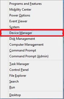

Launch Device Manager:
Windows 7: “Start Menu”-> right click the “Computer” -> ”Manage” -> ”Device Manager”
 Windows 8: press “Windows+X” Key and open “Device Manager”.

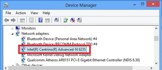

1. Intel:

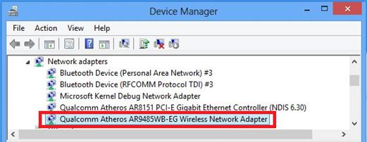

2. Qualcomm Atheros:

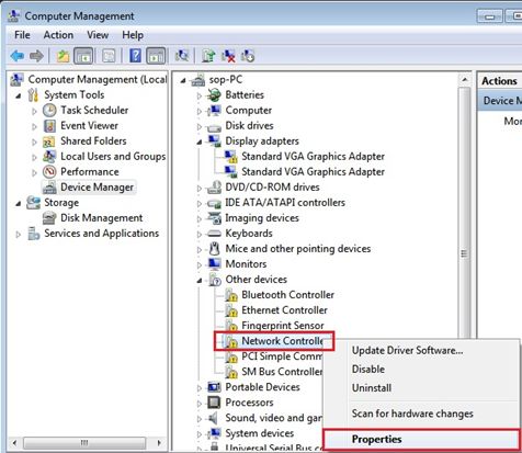

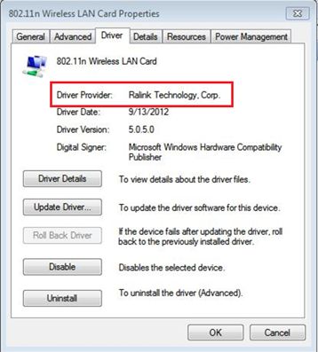

4. Mediatek (Ralink): Please right click the “802.11N Wireless LAN Card”, choose “Properties” and then check the Vendor.
If yellow exclamation mark appears , please find the ”Network Controller”
Then you can find the vendor of WLAN driver
