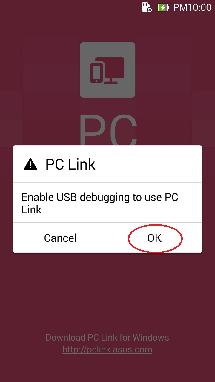

Step 1. Check whether “USB debugging” is enabled in you mobile device?
a. Launch PC Link and a dialog will shows up if “USB debugging” is not enabled. Select [OK]

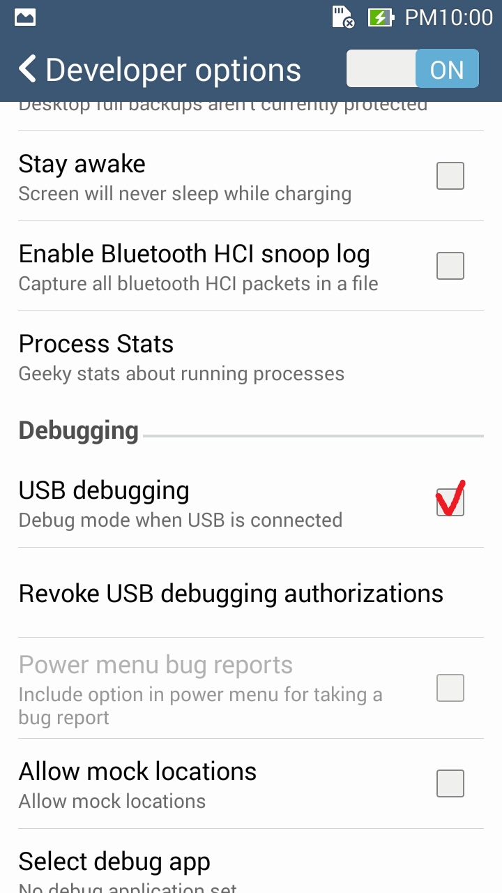

b. Check “USB debugging” option

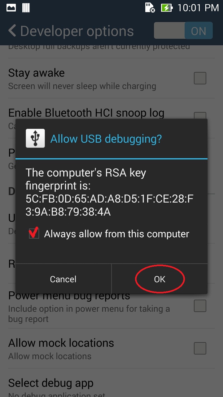

d. Always allow from this computer and select [OK]

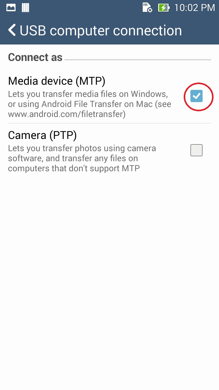

Step2. Make sure either MTP or PTP is enabled

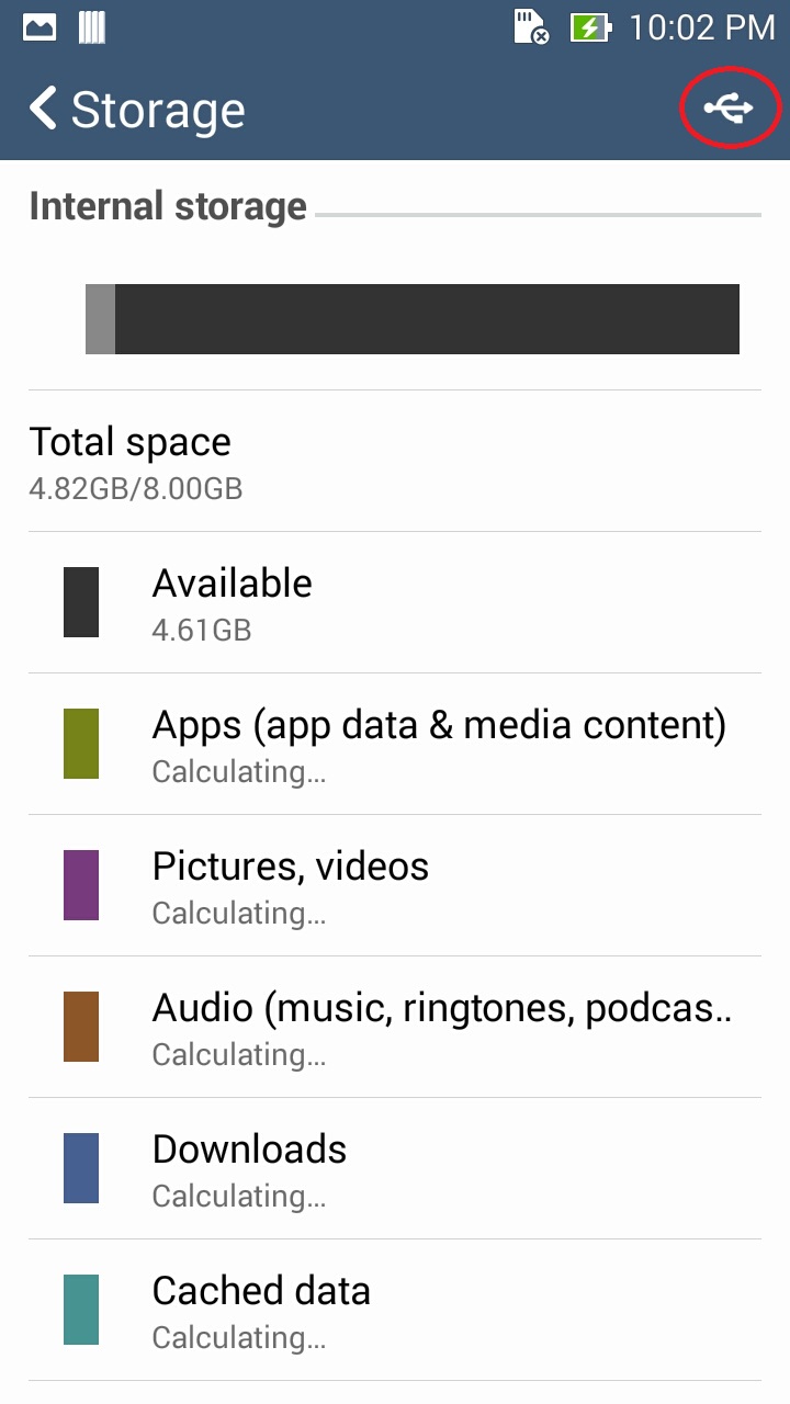

a. Enter Storage setting
b. Click the USB icon in the upper-right corner
c. Check [MTP] (suggested) or [PTP] option
