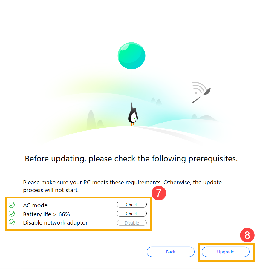

  5. Three prerequisites need to be met in order for the upgrade to proceed.  Click [Upgrade]to start the upgrade process.
    Note: If the prerequisite shows as , but you are unable to begin the upgrade, please reconfirm that all the prerequisites have been met.

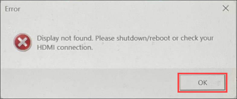

    If you receive the following error message, please click OK.  During the upgrade process, the notification may pop up due to some ScreenPad 1.0 functions cannot be used, which is normal and will not cause any issues with the upgrade.
