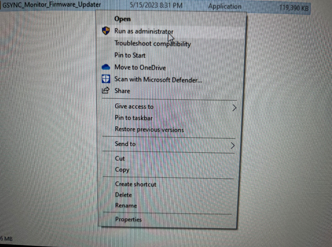

Step 1: To begin the firmware update process, it is necessary to launch the GSYNC_Monitor_Firmware_Updater.exe application in administrator mode.
This can be accomplished by right-clicking on the GSYNC_Monitor_Firmware_Updater.exe file within Windows Explorer and selecting the option "Run as administrator.

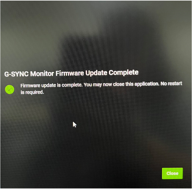

Step 5: How to check if the update works? How to enable ULMB 2?
The update complete notice would appear after the update is successful.

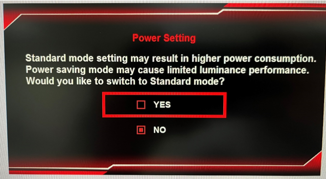

A power setting notice would pop up, tick YES.

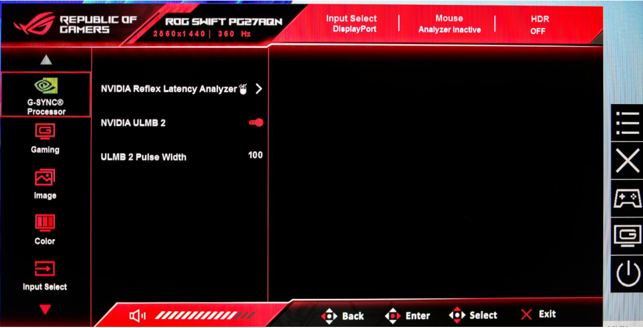

Enabling ULMB 2 on capable 1440p 360Hz monitors updated with the new firmware is easy:

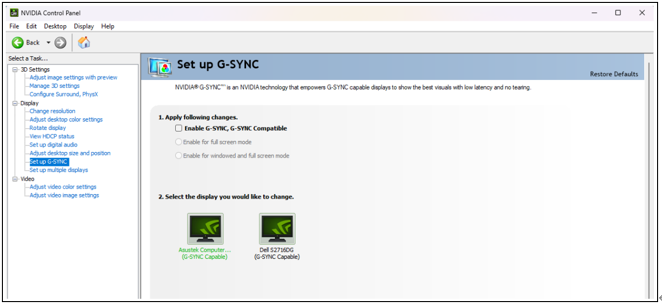

1) Disable NVIDIA G-SYNC Variable Refresh Rate in the NVIDIA Control Panel and set the monitor refresh rate to 360Hz. This will allow the backlight to enter backlight strobing mode
<Disable G-SYNC in the NVIDIA Control Panel>
2) Enable G-SYNC ULMB 2 in your monitor’s on screen display
Once you have done these two steps, you’re ready to go!
