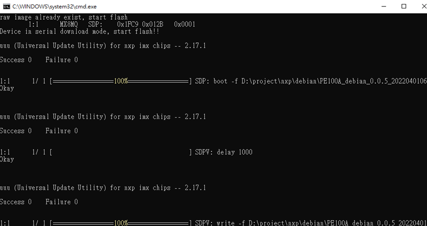

Case 1. Flash an image in serial download mode (For unbricking)
If device is in brick state or is with an empty eMMC, we can use “serial download mode” to flash an image.
you can download Debian image from ASUS Website
Flash image:
i. Toggle boot_mode switch to “Serial downloader” + “eMMC boot ” (OFF : ON : OFF : ON)
ii. Power the device with an adapter.
iii. Connect the device and host computer (PC or NB) with USB Type-C® cable
iv. Enter image folder and double click flashall.cmd (Windows) / flashall.sh (Linux) to start image flashing.

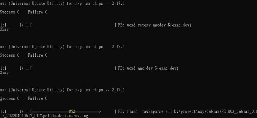

Case 2. Flash an image in fastboot mode
Use “reboot-bootloader” command to make device enter fastboot mode so then the OS image can be flashed directly.
Flash image:
i. Power the device with an adaptor, and wait for the device to boot into Debian OS.
ii. Open a terminal windows and enter “reboot-bootloader” command.
iii. The device will stay in fastboot mode.
iv. Connect the device and host computer (PC or NB) with USB Type-C® cable.

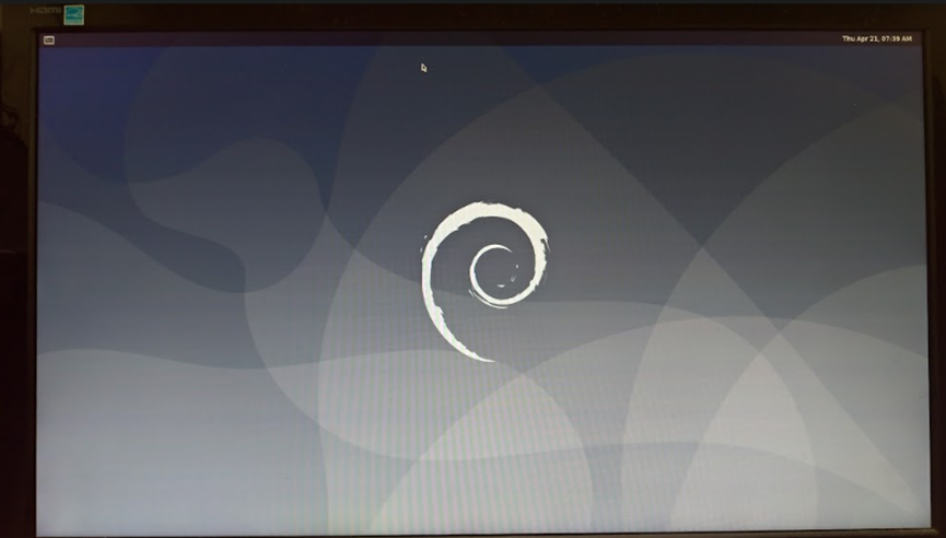

vi. The device will reboot to Debian OS automatically once the process is completed.
